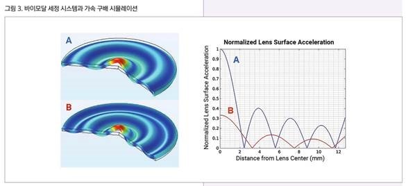

2. They saw that ULC1001 make 2 different frequencies to remove dust on the lens. Does ULC1001 make 2 different frequencies at the same time? or make one frequency and then make other frequency? (not same time?)

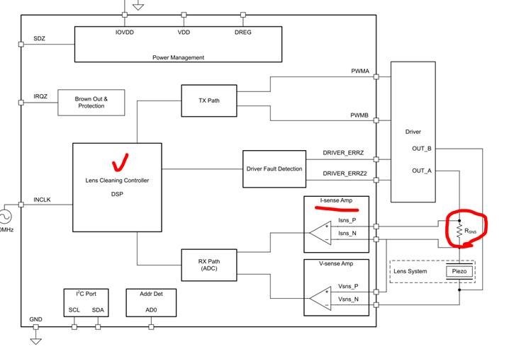

3. How can ULC1001 track the frequency of piezo transducer? (using impedance tracking? or something else?)

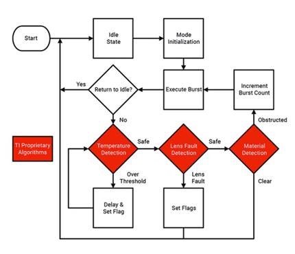

4. They saw that ULC1001 have flow algorithm for correcting resonant frequency of piezo transducer, depending on the ambient temperature. Could you explain more about the flow chart below?

    2. ULC1001 does not drive these frequencies at the same time. They are run in a sequence of bursts.
    3. ULC1001 uses the IV sense path to take measurements of the LCS during calibration and also measure the temperature and detect mass in operation. During operation, ULC1001 does not track and update the drive frequency.
    4. The device does not actively track and update the resonant frequency of piezo transducer. Various measurements are taken during calibration, and then used to update the cleaning bursts. The two measurements that use the IV sense path during operation are the mass detect burst and temperature detect burst. These bursts gather data and compare it to the calibration calculations. Essentially the temperature burst will calculate the temperature of the LCS and if it is over the temperature threshold, it start a cool down state and then continue operation once it reaches an operable temperature. Similarly, if the mass detect burst detects a frequency shift over the threshold, it will execute the following cleaning bursts in the sequence (water cleaning, etc.). If mass is not detected, it will stop the sequence.
