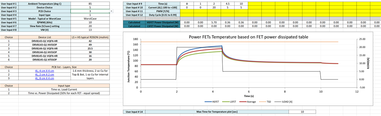

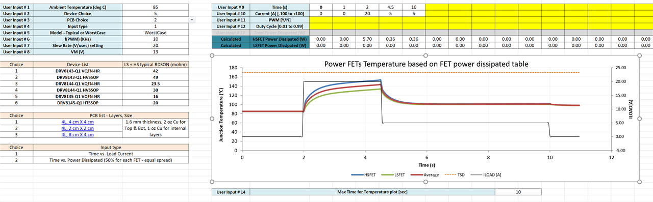

As discussed per email, when using a bigger PCB for a 20A during 2.5s then steady 5A, the tj estimation tool is not working properly for any of the devices with PCB selection.
Indeed the bigger the PCB the bigger the Tj, unless i missed something..
