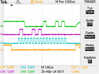

    here is a print from the scope.
    The SCS signal is in yellow, the clock is in blue, the SDI is in red and the SDO is in green.
    As you can see, I had sent the code 0x4500 and got back the code 0xE045 (UVLO is high).

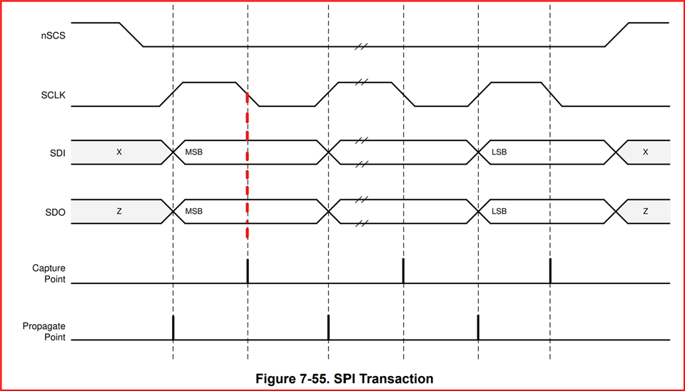

    In your capture the clock phase CLKPH is not matching with the DRV8462 SPI CLKPH requirements. This should be an SPI mode setup in your MCU. Some MCU vendors don't really match mode numbers exactly. You may be reading out an incorrect SDO value because of this incorrect CLKPH setup.
    Also whenever you wakeup the device nSLEEP 0 to 1, you must wait tWAKE (0.25ms) datasheet specification, before starting an SPI transaction.
    See datasheet page-71.

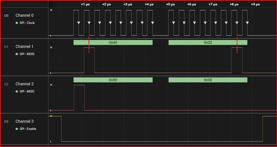

    Here's an example capture of an actual functioning SPI transaction capture:
    The gap between the two bytes is normal for some MCUs but don't impact operation. Two bytes with no gap is fine as well, CLPH alignment is important.
