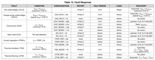

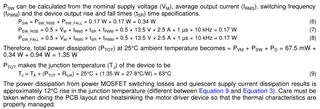

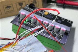

Customer feedback uses TI's DVR8873S chip. Eight DVR8873S chip materials are used in one product, and heat sinks are added to the front and back ends of the chips. The following tests have been carried out.
1. How to calculate the heat dissipation area of PWM100% when the chip is working at full load?
2, the product only uses one chip PWM80% output, normal output about 5 minutes later, the chip will stop output, at this time set a lower PWM can not be normal output, at this time the temperature of the infrared temperature chip is about 80℃. What is the reason to protect no output?
3. When the product uses only one chip PWM70% output, it is tested for 40 minutes and the output is normal. At this time, the temperature of the infrared temperature core is about 70℃.
The Picture 1 shows the PCBA,The picture2 shows the Cooling fin,the picture3 temp test data( the pwm is 70%).
