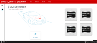

Customer want to develop the motor drive first by default or reference program? Can the EVM GUI setup a motor drive and burn the registers inside?
The question is same for DRV8343S-Q1
Hey Josh,

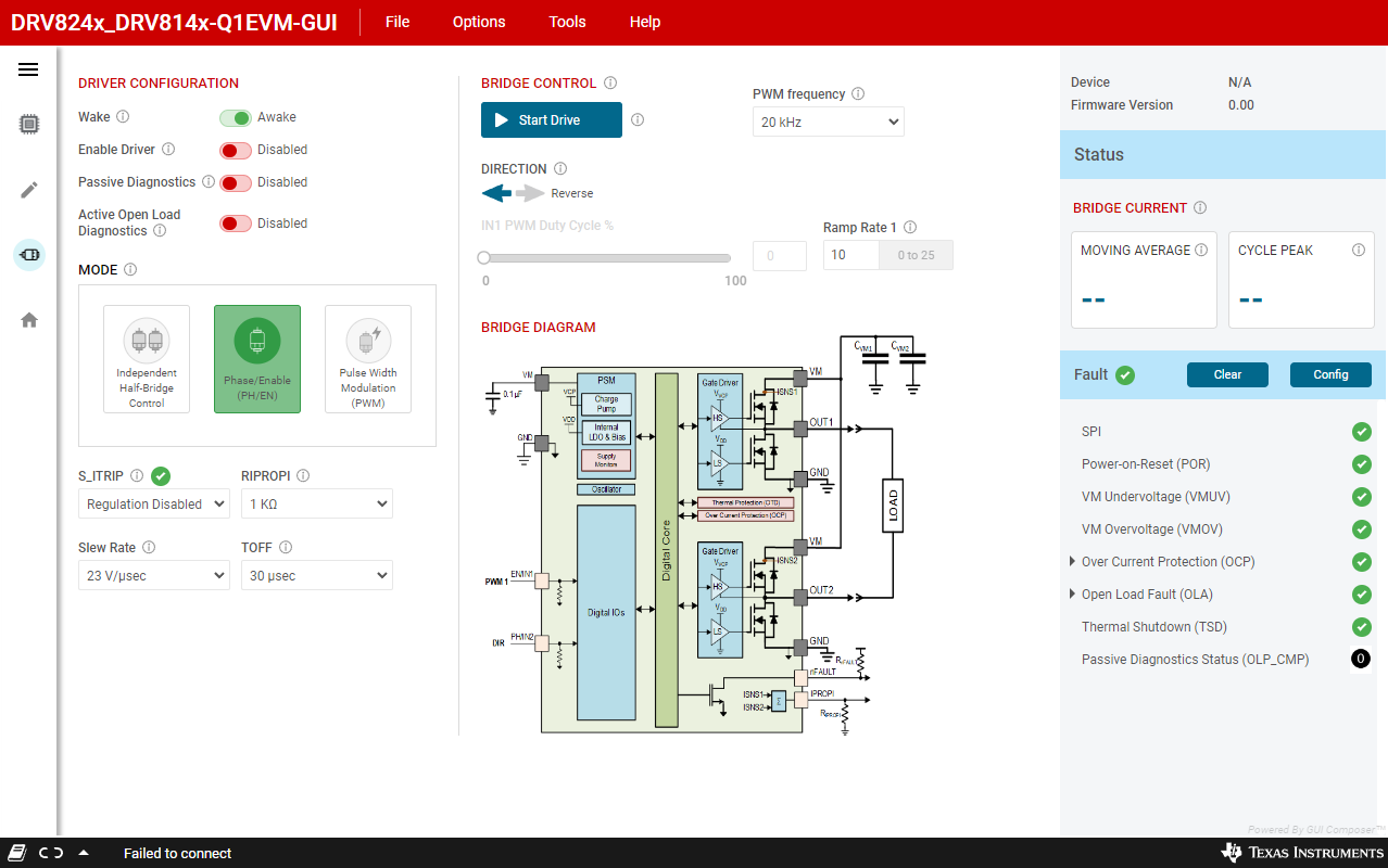

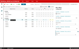

Yes, please have them order the DRV8243S-Q1LEVM . It works with a Web GUI (https://dev.ti.com/gallery/view/MotorDriversBSM/DRV824x_DRV814x-Q1EVM-GUI/ver/1.0.1/) that gives easy configuration of the device. See the DRV824x_DRV814x-Q1EVM User’s Guide for how to use the GUI and EVM.
Same for the DRV8343S-Q1 - https://www.ti.com/tool/DRV8343S-Q1EVM You can find this by going to the "Design & Development" section of the product page https://www.ti.com/product/DRV8343-Q1#design-development
Web GUI look:
Register map page:
