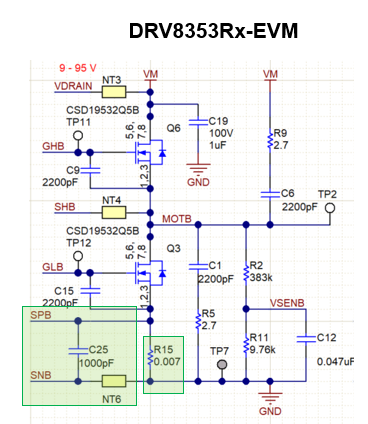

 In DRV8353H, I have two queries:
Query 1:
 SPA,SPB,SPC pins are common for bottom phase gate current return path and Current sensing input to the driver for the respective phases of A,B,C. if i have to add filter after shunt sensing(i.e Filter at input of Gate driver current amplifiers), Could you please suggest a scheme for this ? I could see that, if i add filter, it will break the Current path bottom FET gate current.
    For filtering on the CSA input pins, we actually recommend a filtering capacitor from SPx to SNx, like the following diagram for the DRV835x:
    This does not affect the current return path as current is still flowing through the shunt to GND, and the votlage differential across the shunt is what is being inputted.
