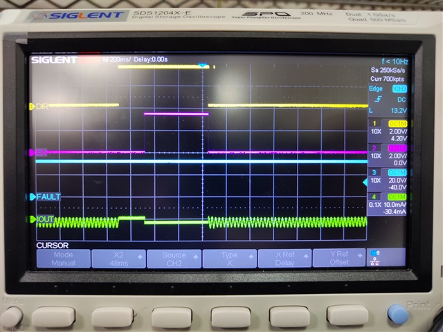

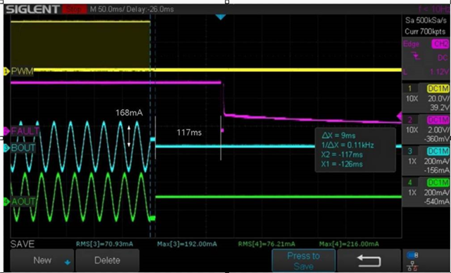

I used DRV8889 to drive the motor to rotate forward and then reverse immediately, and an Open Load Fault occurred. Test result is as below
However, 200ms before the Fault occurs, the motor current is not lower than 30mA, which means that there is no condition to trigger Open Load.
So I want to ask, what else might trigger Open Load?
It was confirmed through the SPI message that the FAULT pull Low was caused by Open Load, but there was no abnormality in the two sets of output currents of DRV8889. Is there any other phenomenon that may cause Open Load fault?

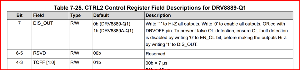

  • Hi David,
    See below section from the datasheet. Looks like at the STEP of direction reversal you may have stopped the forward motion at either one of those four electrical angles where one of the coils was zero. See also Table 7-3. Relative Current and Step Directions in the datasheet page-17 for A and B currents for each microstep.
    There is also one more condition that could falsely report OL. This is not related to the behavior you encountered. See below.
    Regards, Murugavel
  • Hi Karan,
    This is normally picture
    This is faullt occurred
    Thanks & best regards,

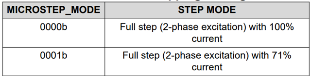

  • Hi Murugavel,
    The setting of MICROSTEP_MODE is the default value. The default value is Full_step mode. Will this cause OPEN_Load fault?
    "This situation does not arise in full-step mode, because the coil currents are never zero."
    OPEN_Load fault occurs, how to determine whether it is caused by 0°, 90°, 180° or 270° electrical angles?

  • Hi David, can you please probe the following and share the scopeshot:
    Current waveform where motor was rotating in the forward direction for some time, DIR signal was changed, and fault occured.
    Please probe STEP signal, DIR signal, AOUT1, and nFAULT.
    Additionally, can you tell us the value of the itrip setting? It looks like the current is sinusoidal in the first scopeshot you have shared. This should not be the case if you are using fullstep mode.
    Karan
  • Hi Karan,
    Work normally :
    Fault occurred

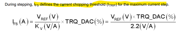

    After IFS decision, Itrip has been confirmed. Is itrip setting the setting of IFS?
    Could you tell us how to set the itrip setting?
  • Hi David,
    Yes, Itrip and Ifs are the same. My mistake, I should have said Ifs. To set Ifs, set a value for the TRQ_DAC through the TRQ_DAC register (see the register map section in the datasheet) and apply a VREF voltage. Ifs will be set according to the equation you have shown.
    Can you please tell me the peak value of motor current from the o-scope?
    Based on the waveforms you have shared, I believe you stop giving step pulses when DIR is changed. This results in the motor current stopping at a certain value. If the motor current value at that point is more than 30mA, it will not detect open load. But if it is below 30mA, open load will be detected.
    Also, can you please share your register settings? I am trying to understand why the motor current is sinusoidal when you are using full step mode.

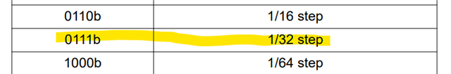

  • Hi Karan,
    1. OL_TIME: 200ms
    2. MICROSTEP_MODE is not Full_step mode, it is 1/32 step.
    3. IFS current: 160mA
    When the STEP signal stops (the motor stops operating), the MCU will write to the registers of DRV8889 TRQ_DAC (0110 62.5%) and SLEW_RATE (01 10.8V/us). Then a OPEN_LOAD fault will occur.
    Can you help me find out what causes OPEN_LOAD Fault? is there a solution to fix it?

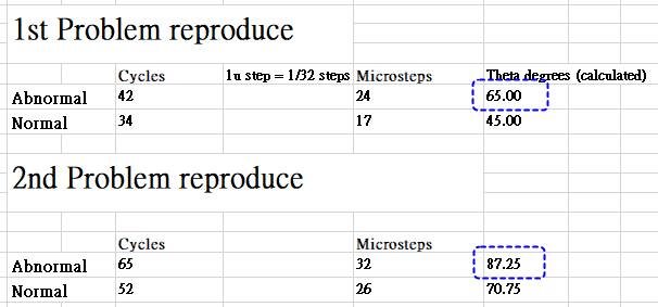

  • Hi Karan,
    RnD has to confirm the rotor position. The position is not at 0,90,180,270.
  • Hey David,

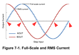

    Interesting to see it occurring outside of 0/90/180/270°.
    One way to verify it is when OL_A or OL_B is reported, move the motor one more micro-step away. If OL_A doesn't be reported on the new step. The original OL_A is not true. Note that OLD is Report-Only, so you are fine to add into your code ignoring the OLD on direction change.
    In your table above, the "24" microsteps, what does that mean?  Our device does not have 1/24 microstep, only 1/16 and 1/32 (and others).
    In this image below, it looks to me like the motor current is at 0 at the time you stop or change direction.  It looks like you complete ~56 full electrical cycles, ending at 0 current.  Am I incorrect?
    Open load detection won't work when current is at these spots (red arrows):
    Jacob
  • Hi Jacob
    The value of Microstep is the count of STEP
    “ you are fine to add into your code ignoring the OLD on direction change. "
    Does this solve the problem of OPEN_LOAD Fault? Why?

  • Hi Jacob and Karan,
    Is there any recommended process (register setting) after DRV8889 turns on or before DRV8889 turns off?
    Is there any recommended process (register setting)  in direction changing  (forward -> reverse, reverse -> forward)?
    Thanks and best regards,
  • David,
    Please refer to the application section in the datasheet for example settings. It also shows a detailed design procedure.
    In all the fault scopeshots you have provided, the sine wave approaches 0° except the second one. I assume this is what is causing the fault as explained above. In the first fault scopeshot image, the wave is at 90° which leads me to believe that the other output is at 0°. I recommend that you verify this by zooming in to the current waveform. Feel free to share with me if this is not the case.
    As Jacob has pointed out, the OL detection fault is status-only. It will not stop the driver operation.
    Let us know if you have any more questions.
    Karan
