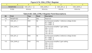

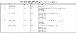

I use DRV8714 in my design, when open load, I put sleep high, then set registers.
I test SO1 & SO2's voltage, Vso1=3.4V,Vso2=2.2V, it make me confused.
My question is
1. why Vso1 and Vso2 has too much diff?
2. when open load, I think Vso1 and Vso2 should be 2.5V, It doesn't meet my test result.
register setting:
0x07set: 0xe6
0x08set: 0x42
0x28set: 0x07
0x27set: 0x07
other register is default setting.
