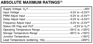

    Can you elaborate on this?  Make sure the input voltages comply with the absolute maximum ratings table
    What is your voltage on the Delay Adjust pin?  If below 2.6V device will be 100% ON.  Also what is your voltage or resistor for the Duty Cycle Adjust pin?

    "What is your voltage on the Delay Adjust pin?"
    it varies from the range 4.9 to 5.3V  varies based on the  the duty cycle voltage.
    "Also what is your voltage or resistor for the Duty Cycle Adjust pin?"
    giving voltage from DAC from 1.3 to 3.5 volts
    Make sure this voltage does not exceed 5.5V as that could damage the device.

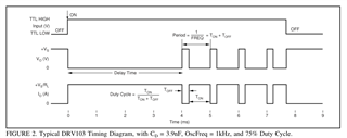

  • 1.after I turn off the input signal, still it shows the PWM output(oscillator probe is connected to pin 5 and GND). (according to data sheet it should off below 1.7V)
    could you please explain what might be the reason.?
  • Not sure, I don't think that is expected behavior.  Could be damaged device?  Does it stay on continuously, or just for a few ms?
    Looks like voltage will stay high, but current will be zero.
    Note that the output will be disabled below 1.2V and enabled above 2.2V.  Between 1.2V and 2.2V is a gray area, don't know what the behavior will be.

  • Hey Showrya,
    what exactly is TTL input is and what is the difference between analog input and TTL input
    TTL input just means it supports TTL voltage levels, which are where low is <1.2V and high is >2.2V in this case.  for TTL stands for transistor-transistor logic. This is an old-fashioned way to describe an input, just saying that it can handle up to 5V not just typical 3.3V directly from a microcontroller.
    disconnect the input
    Ahh, well disconnecting the input is different from driving the input low.  Since the device doesn't appear to have a pull up or pull down resistor on the input pin, when the input goes Hi-Z (disconnected) then it will likely maintain the previous voltage state.  It might eventually float up/down to the other state.  Since it's Hi-Z it's unknown what voltage the device will read.
