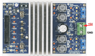

    Where should I the 5V-Powersupply (+5 and ground) and where should I connect the PWM-Signals and the ground from the microcontroller ?
    5V and GND on the green screw termpinal.  5V onto PVDD, GND on to GND.

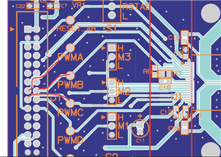

    PWM signals can go onto the orange test points PWMA, PWMB etc, or on the ribbon cable header as you show.  To confirm you got the pins right I would use a multimeter to test for continuity between a test point and the header pin, like measure between PWMC and pin 17 on the header.
    I don't think your diagram is correct for the pins.  See the PCB layout in the user guide - you can trace the signals from the orange test point to the header. See the below image where I used red pen to trace PWM A/B/C to their pins
    And why are there multiple ground and +5V-Inputs ?
    For current capability.  The cable on those ribbon cables is typically very small, often 26-30AWG.  A 28AWG wire current rating is around 1.4A.  If you parallel them you can roughly add up the current rating, so 2.8A for two wires etc.  The 5V rail shouldn't need more than 1.4A but better safe than sorry.

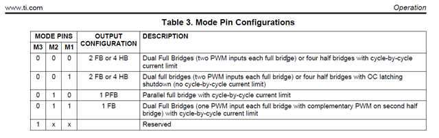

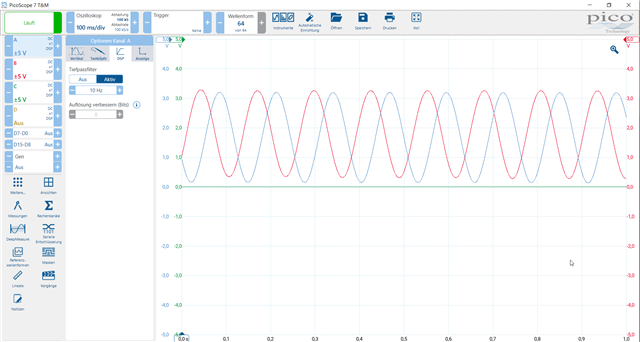

  • Thanks. I managed to get Output A and B running.
    Output C doesn't show any curve, although PWM_C-Pin is connected.
    This is what the Output looks like on the oszilloscope:
    Output C is zero. Maybe you have an idea why this happens ?
    Maybe I have to configure the board differently ?
    The microcontroller Pins go directly to the PWM_A, PWM_B and PWM_C-pin on the board and I haven't used inverted PWM-Pins.
    Thanks...
  • Hey Maik,
    Please see the DRV84x2 datasheet: https://www.ti.com/lit/ds/symlink/drv8412.pdf
    I believe you'll need to be in the 4 Half-Bridge mode, one of the first two modes here:
    Jacob
