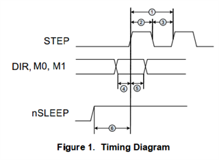

I am currently using the STEP signal to control the motor pulses:
NO. PARAMETER CONDITIONS MIN TYP MAX UNIT
1 fSTEP Step frequency 250 kHz
2 tWH(STEP) Pulse duration, STEP high 1.9 µs
3 tWL(STEP) Pulse duration, STEP low 1.9 µs
4 tSU(STEP) Setup time, command to STEP rising 200 ns
5 tH(STEP) Hold time, command to STEP rising 1 µs
6 tWAKE Wake-up time, nSLEEP inactive to STEP 1 ms
Will changing the ratio of tWH and tWL affect the operation of DRV8834 under the timing requirements above?
THANKS!
  • Hey He,
    Our devices trigger the step movement on the rising edge of the STEP signal.  Duty cycle of the signal doesn't matter, as long as you obey the 1.9us minimum time of the signal.
