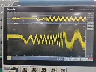

    If the above changes do not resolve the HW_LOCK_ILIMIT error, please provide two captures:
    1. The motors phase current from when the motor startups to when it faults
    2. A zoomed in capture of the motors phase current when the fault occurred

  • Hi, Joshua
    I reset the registers by referring to your answer.
    I measured the motor Rs, Ld, and Lq again using the motor parameter identification function in Insta-spin.
    - Rs : 0.3847 ohm
    - Ld/Lq : 14.4 uH (ultra low)
    For the drive test, the quick spin function was not used, and commands were sent through I2C communication.
    Motor control is unstable and speed is not controlled using I2C.
    Please refer to the json file and driving waveform and let me know which registers need to be changed additionally.

  • Hi, Joshua
    1. I set the current and speed KP and KI gains to 0 and MPET was successful.
     > I increased the I2C command percentage using the value extracted through MPET, but control was not good. What is the reason?
    Please refer to the contents of the *.json file. (The json file is the contents of the successful MPET.)
    2. CTRL_Mode was driven by Modulation index control. It was not possible to drive at the desired speed, and the motor rotation direction suddenly changed to the opposite direction during operation. What is the reason?
     > Please refer to the attached picture file.
