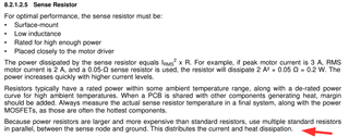

  • Hey Raymund,
    1.84W seems correct to me, but I am not sure about what you're initially asking.  Do you mean for the sense resistor?
    Jacob
