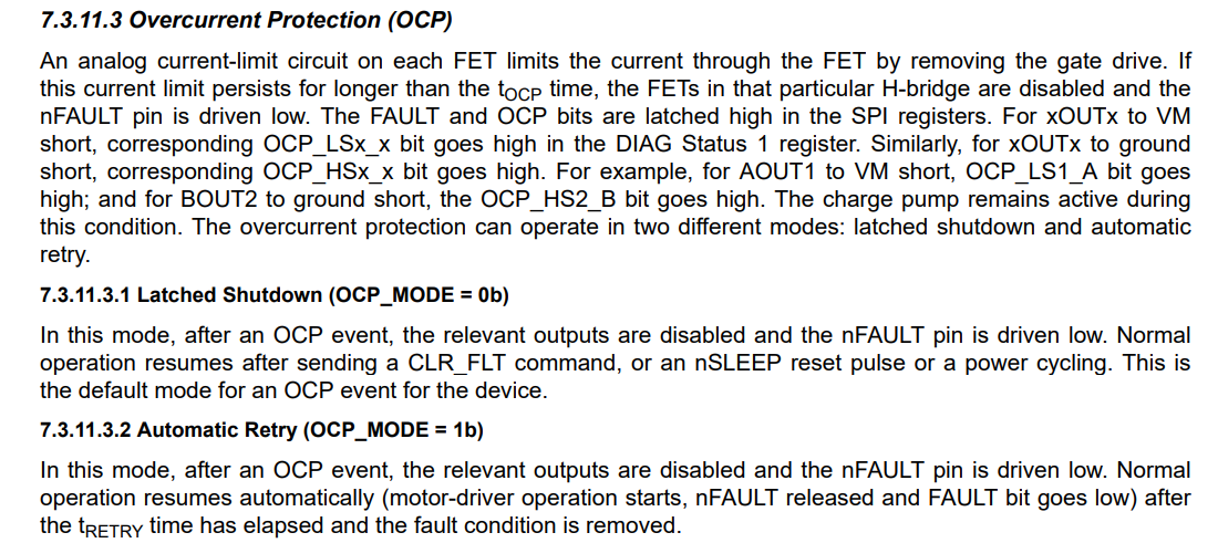

The overcurrent protection triggering mechanism in the DRV8889 chip is: Iout>Iocp and the duration exceeds tocp (3us).
Is the same for short to BAT or GND? Is the duration also tocp (3us)?

Hey Mingkang,
Yes, see the OCP section below. Same duration spec for OCP to VM vs GND.
