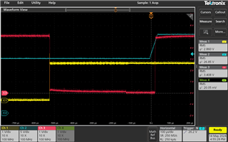

         It is a waveform of Cp1 and Cp2 when the motor is in operation.
         CP1 : Yellow , CP2 : Blue
    It is the waveform of Cp1 and Cp2 when the motor is not operating.

  • Hi Joshua.
    Today I changed to 1uf-50V and tested it. The CPFAIL bit is set to 1 when the motor is running.
    When the motor is running, after setting the CPFAIL bit to 0, the cpfiale bit remains 0. However, when the motor is stopped and operated again, the CPFAIL bit becomes 1 again.

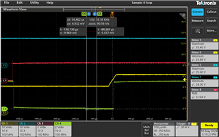

  • Hi Shshin,
    Can you provide a capture of the VM voltage and the VCP voltage when starting the motor? I want to check if the voltage on VM is dipping when the voltage on VCP dips.
    Joshua
  • Hi Joshua.
    Here is a waveform measuring VCP and VM.
    In my opinion, the VM voltage does not drop when the VCP voltage rises.
    Blue : VM / Yellow : VCP

  • Hi Shin,
    From the capture it appears like the device is coming output of a standby or sleep mode or powering on. If the ENABLE bit is set to inactive the VCP and VREG will be disabled. When VREG and VCP are disabled, VCP will be ~VM voltage and VREG will be ~0V. Can you check if the ENABLE and/or RESET pins are changing states close to when the VCP begins to rise? If these pins are changing states when the device is coming out of or going into a sleep mode this will disabling/re-enable VCP causing CPFAIL to re-assert.

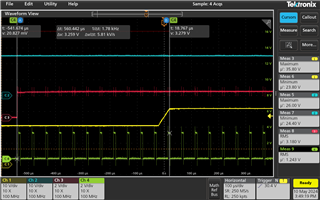

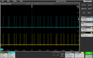

  • Hi Joshua,
    Blue : VM , Red : ENABLE, Yellow : VCP, Green : FAULTn
    FAULTn signal changes to High->low->high when the motor is running, is this normal?
    The meaning of this question is, does the FAULTn signal keep Hgih when everything is normal?
    Why does the FAULTn signal change to high again?
    Blue : VM, Red : ENABLE, Yellow : VCP, Green : CLKIN
    Can Cpfail happen because the SCLK signal goes straight in when the ENABLE signal changes to low->high?
    Does the VCP voltage rise if there is no PWM input in the CLKIN and the ENABLE signal is entered as low->high?

  • Hi Shin,
    If this is occurring when the motor is spinning and without ENABLE being provided a signal that is low->high or high->low then there is an issue, please provide the fault being reported. If this question is related to the capture please see my comment to the next question below.
    I see that the enable bit is low and then goes high near the beginning of the captures. When ENABLE is low the device is put in a low power state were all analog circuitry is disabled including the charge pump (VCP) (see section 7.3.3 of the datasheet). When ENABLE is set back to high the DRV8308 goes though a wakeup routine which can take a maximum of 1ms (see section 6.6 of the datasheet).During this wakeup time the analog circuity is turned back on, although FAULTn is woken up before VCP in the wakeup sequence which leads to the FAULTn pin being pulled low since VCP is below the CPFAIL threshold. When the VCP pin wakes up the FAULTn pin will be pulled high since the VCP voltage is now above the CPFAIL threshold.
    Yes the VCP voltage will rise even if there is no PWM input into CLKIN when ENABLE is set from LOW to HIGH.
    We expect a CPFAIL to occur anytime the ENABLE is provided a low->high signal. When ENABLE is provided a low signal VCP should go from >VM+3V to ~VM.

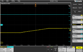

  • HI Joshua.
    Red : FAULTn, Yellow : ENABLE, Blue : VCP
    Looking at this waveform, when the ENABLE changes to Low-> High, the FALTn signal appears to be output as High-> Low
    because the VCP is before the VM +3V voltage.
    After the VCP voltage rises, the FAULTn signal changes to Low->High.
    Is it correct that the CPFail bit does not automatically change to 1 -> 0 at this time?
    Should the user directly set the Cpfail bit to 0?
    Is there any way to quickly increase the VCP voltage?
    I think CPFAil will definitely occur on the board I'm testing
    Is there a way to prevent CPFAIL from happening?
    Is it helpful to measure the signal on the HSU side when the ENABLE signal changes to low->high?

  • Hi Shin,
    Correct, the CPFAIL bit will not automatically change from a 1->0. CPFAIL will remain set as 1b until a 0b is written to the CPFAIL bit by the user. After setting ENABLE from LOW->HIGH and waiting 1ms, you can set the CPFAIL bit to 0b to clear the fault. If the CPFAIL bit gets set again without the ENABLE bit going from LOW->HIGH then a issue maybe occurring.
    The time that the VCP voltage rises after the ENABLE pin is pulled high cannot be changed. This time will vary from device to device due to production variation but we expect that VCP will rise before the 1ms wakeup time.
    When ENABLE goes from LOW->HIGH CPFAIL cannot be prevented. CPFAIL occurring when ENABLE goes from LOW->HIGH is expected.
