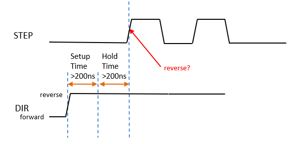

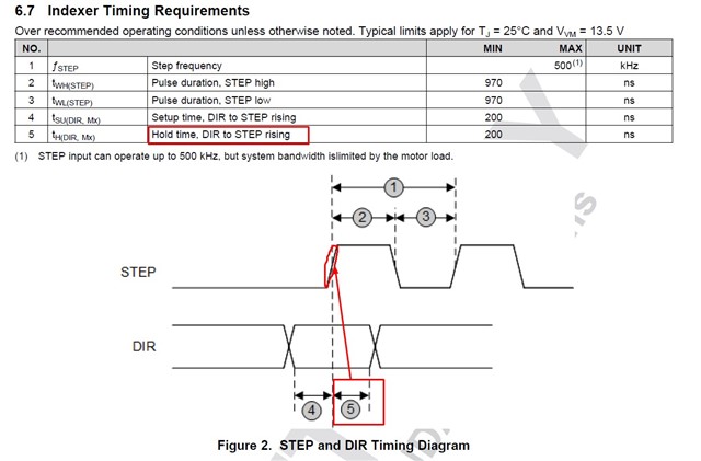

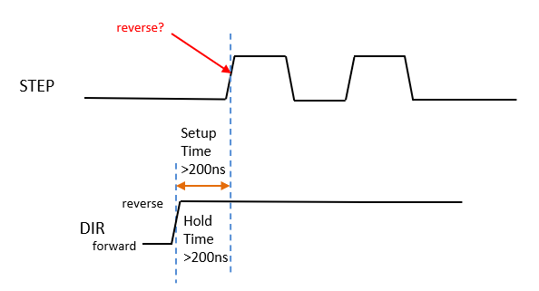

The conditions of tH Hold time and tSU Setup time are both DIR to STEP rising, but the marked positions of their timing diagrams are different.
As indicated on the timing diagram, will the direction not change until the next STEP?
What is the correct timing diagram of DIR and STEP?
