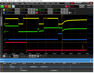

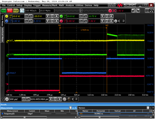

1. tWAKE and tSLEEP verification results are inconsistent with datasheet.
datasheet P9, wakeup time should <1ms, sleep pulse time should>120us ; The actual wakeup time measured is 1.74ms and tSleep is 86.7uS. Please confirm whether the test result is correct.

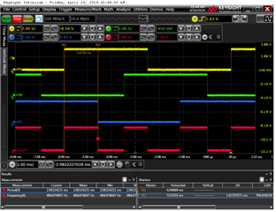

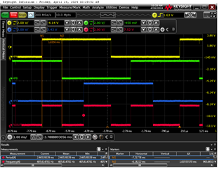

2. Timing diagram of Hall sensor. In datasheet P25, the hall signal of DIR=0 and DIR= 1 is the same. It should actually be inconsistent. The actual signal is shown below. DIR=0 on the left and DIR=1 on the right, please confirm.
