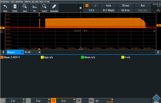

I measured the voltage on one of the phases and the signal looks like this:

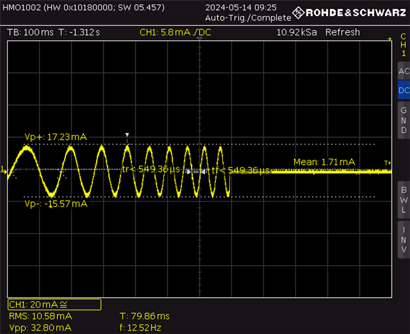

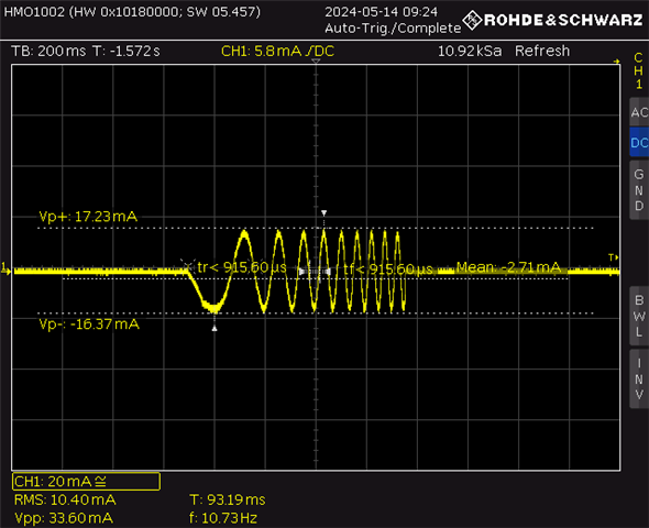

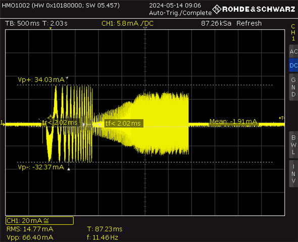

  • Hi Joshua,
    1. I tried to skip MPET and set the resistance, inductance, BEMF constant, and the SPEED KP/KI. I also disabled the SPEED_LOOP_DIS. However, the motor starts spinning and then stops when the algorithm state is 9h (MOTOR_CLOSED_LOOP_ALIGNED), with no fault reported. How can I solve this?
    2. I tried using another motor (Mexon EC motor, 3-phase, 1 pole pair). MPET is still not functioning correctly. I got the motor's resistance, inductance, and BEMF constant from the datasheet, set all these values, and the SPEED KP/KI. I also disabled the SPEED_LOOP_DIS. The motor starts spinning and accelerates really fast (the algorithm state is 8h = MOTOR_CLOSED_LOOP_UNALIGNED) and then stops with a fault.
    The CONTROLLER_FAULT_STATUS register (Address = E2h) shows 0x80900000 (ABN_SPEED, MTR_LCK). I am setting the speed to 0x4000 (50% of max speed), and the max speed is 0x012C. When I read the value from the FG_SPEED_FDBK register (Address = 216h), it shows 0x56F4DE80 (32608 rpm). The SPEED_FDBK register (Address = 752h) shows 0xA88ECF70 (63209 rpm).
    How can I fix this?
    Alima

  • Hi Joshua,
    Sure, below you can find the attachments.
    First motor: Stops spinning, no fault detected
    Second motor: Stops with a fault

  • Hi Alima,
    Please try decreasing the open loop acceleration (OL_ACC_A1) and closed loop acceleration (CL_ACC) until the motor is able to spin up correctly. We also recommend slowly increasing the speed command when SPEED_LOOP_DIS is set to 0b. When the speed loop is disabled the speed command will set the target current to the speed command % of the set current limit.
