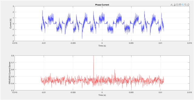

I am testing DRV8329AEVM with LAUNCHXL-F280049C.  I was able to spin the motor using an example program for the BLDC trap drive but I have an issue sensing the phase current. The output of the DRV8329A seems to be always stuck around 0.4V regardless of the motor phase current.  See the plot below.
Would you be able to let me know what might be going on here?
