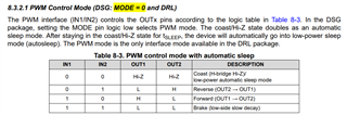

What happens when VCC, EN and MODE is set low to but still has VM , will the motor go in to Break or Coast ? . Thinking of drive the motor with a specific pattern of pulses (not using PWM) and don´t want the motor drive go into brake between those pulses.
regards
mats
Hi Mats,
Switching from the Forward state to the Brake state does not imply that the motor will "brake". Both Brake (slow decay) and Coast (fast decay) are current recirculation techniques to help dissipate the current in the load safely.
It is recommended to switch between Forward/Reverse and Brake as it is an efficient recirculation method when driving a motor.
When MODE is set low, the control mode is set to PWM.
To see all the control tables please see section 8.3.2 Control Modes in the datasheet.
For more on Current Recirculation and Decay Modes, see the following application report:
Current Recirculation and Decay Modes (Rev. A)
