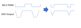

what would be the resolution of the PWM between 90% and 100%?
Is there a restriction on minium off-time in our gate drivers?
We know that some architecture when achieving 90% duty cycle they skip directly to 100% but this in some application critical.
So, do we have more description about the behavior between 90% and 100% duty cycle for DRV8702?
