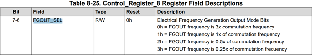

    The same equation applies to MCT8316Z in converting between electrical frequency (Hz) and mechanical frequency (rpm). If you monitor FG, you'll need to be careful to note what FGOUT_SEL is set to, and adjust the equation accordingly. If FGOUT_SEL = 1h, then the equation can be used directly by plugging in FGOUT frequency as the electrical frequency.
    There's not really a hard set maximum RPM for this device. It would depend on each specific motor's parameters and construction. So the max speed is likely limited by the motor's KV rating.

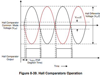

    Edit: It would also be limited by the device's hall deglitch time:
