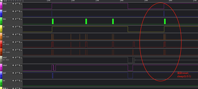

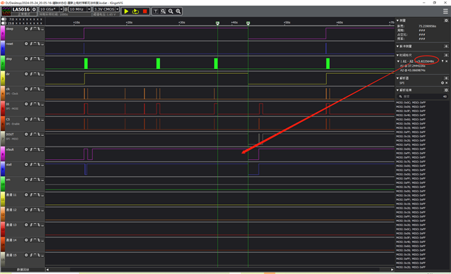

Dears,
    The customer used DRV8711 to drive the stepper motor for 2000 steps and then slowed down and stopped normally. At the end, sets full-scale output current  (TORQUE register set to 0x20)  .After about 5 seconds, nfault occurred and the status register was read as 0xFF.
