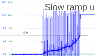

I have configured DVR8874 to be in over-current only fault mode:
But in the application I see charging of a external elko to look like this:
I would expect to not have "current chopping" by my selection of IPROP.
May it be a problem, that nSLEEP is not driven by some logic, but on 3V3 power-up? Or in other words, can the problem be that the IPROP latching does not work the way I designed it?

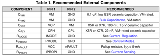

    Can you confirm that the values of the charge pump capacitor C601 and C_FLY (C602) match our external components table?

  • Dear Jacob,
    thanks for reaching out.
    I can confirm, CPump and CFly are X7R of rated value.
    No, the input-signals are static, no PWM.
    The external capacity is 1000µF, the timescalce is 100ms / div. The measurement is taken at the 1000uF cap with a cable of 1m between the two boards.
    If I assemble L600 and remove R601, the output is rising high as expected.
    C612 is 10uF.
    Regrads,
    Simon

  • Hey Jacob,
    The L600 shouldn't be necessary here. The inductor opposes rapid changes in current so it could explain the slow rise, though I would have thought R601 would make the current "skip" the inductor and it be ignored.
    Slight smile I hope so very much!!! Right now we produce with the inductor assembled and the resistor removed. I really want to understand why we need the inductor, as I agree, it should not be necessary from the datasheet.
    Can you elaborate your concern? I don't see an issue with the IPROPI setup - the capacitor parallel with IPROPI resistor is fine, good to filter out spikes.
    Ah, typo. I want to say IMODE latching. It seems like the chip is in current chopping mode, isn't it?
    Simon
  • Hi Simon,
    It looks like the schematic configuration with RMODE tied to GND, the Overcurrent Response is in the Automatic Retry state.
    In this state Current Chopping is set for a Fixed On Time but nFAULT Response is set for Overcurrent Only.
    David
