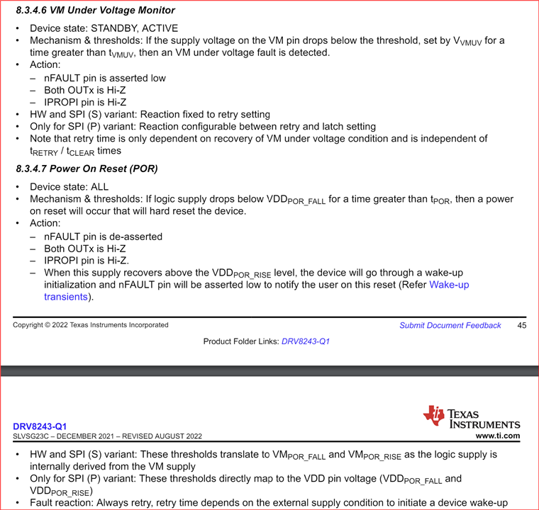

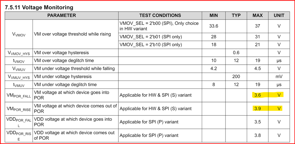

I have several questions for DRV8243-Q1 (S) below:
  1. From datasheet, when VM drops below VMPOR_FALL, all register will reset. But what's the deglitch time for VMPOR_FALL?
  2. When reset happened by VM drops < VMPOR_FALL, the out1 & out2 will also be reset. But does out change from Normal out to reset out directly, or out1/2 may has uncertain state during all registers is being reset?
Thank you!
Marc
  • Hi Marc,
    Please see the below information in the datasheet.
    1. Before VM reaches VMPOR_FALL the device will detect a VMUV condition after tVMUV time lapses. The second snippet show what happens to the driver status as soon as a VMUV is detected. Then, if the VM continues to decrease, as soon as the VM < VMPOR_FALL the device enters a reset state (all registers and digital are cleared. There is no deglitch for this, it happens immediately. After this event when rise back to > VMPOR_RISE an internal POR condition is realized - see second snippet again.
    2. Like I mentioned in #1 a VMUV will be detected and corresponding actions will be executed by the device logic internally.
    Regards, Murugavel
