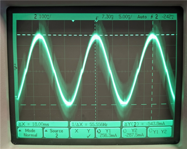

    Here is the current waveform:
    My step to step time is ~78us / ~13kHz steady state. Every 64 steps there is a ~1ms pause while the registers are read for debugging. I have tried removing this pause and just monitoring the nFault pin, however this does not fix my issue.
    I have tried setting both a very low and very high stall threshold and have not been able to get the STL bit to set.
    George
  • Hi George,
    Thanks for the additional information. The current waveform looks reasonable as well as the no load torque count. You said "Every 64 steps there is a ~1ms pause while the registers are read for debugging. I have tried removing this pause and just monitoring the nFault pin". Does this mean you were generating the STEP input pulses using firmware GPIO toggle? I have seen this method creates variations in STEP period, pulse to pulse, that can prevent stall detection. Would it be possible to use a Timer PWM output (hardware based) or an external signal generator with the required STEP pulses for testing this?

    Using a signal generator fixed my problem, I will move to using a hardware timer for the step pulses. There was an occasional jitter in the clock, 4us or so in every few 80us step pulses, I didnt realise the stall detection would be so sensitive to this.
    Thanks, George
  • Hi George,
    Good to know that using a stable STEP input resolved your issue. Yes stall detection is automatically masked if there is a variation in STEP input pulses period. This helps false detection during acceleration or deceleration. Please mark this post as resolved and close it at your end. Thank you.
