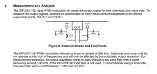

DRV2511-Q1: I'm seeing oscillator frequency in Output
Part Number: DRV2511-Q1
Datasheet has a table about frequences when PWM signal < %96.  I set the FS2 = 0, FS1 = 0, FS0 = 0 and my oscillator frequency is 400 Khz.
I want to see no output when When i applied logic 0 to input (IN+ or IN-) but I seeing 400 Khz oscillator frequency on output . Is it normal or am i doing something wrong?
