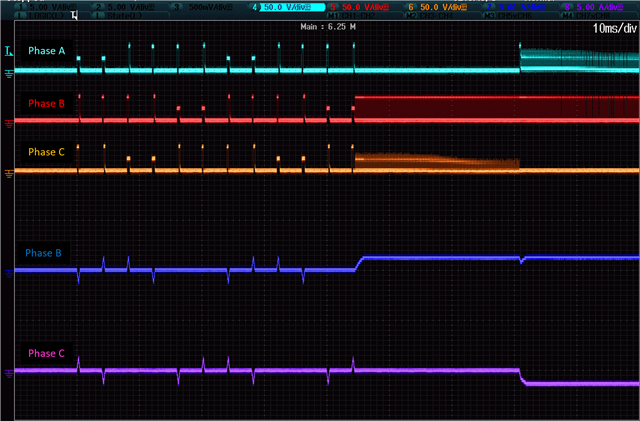

    Currently, abnormal behavior has been confirmed after writing to EEPROM.
    To be specific, IPD is used in the startup sequence, but the IPD does not operate as set.
    However, when the power is turned on again, it operates as set.
    This can be reproduced with MCT8316AEVM, and it is very reproducible.
    The procedure for confirming abnormal behavior is as follows.
    After turning on VM=24V, the following procedure is performed to confirm.

    5. When the motor rotates, an "IPD frequency fault" occurs and the motor does not rotate.
        The waveform at startup at this time is as follows.
    Light blue : Phase A voltage , Red : Phase B voltage , Orange : Phase C voltage , Blue : Phase B current , Purple : Phase C current
    6. Turn the VM off and on again.
    7. When the motor rotates again, no fault occurs and it rotates without any problems.
        The waveform is as follows.
    It is clear that the IPD operation is not as set in 5.
    Also, I do not understand why the operation is as set when the power is turned on again in 6.
    Could you please explain the reason for this?

    I was unable to reproduce the issue you are seeing in step 5. I believe this is due to a difference in the motor being used.
    We typically recommend power cycling our MCx devices after writing to EEPROM to garentee the devices settings are correctly being set to the EEPROM settings. This helps to clear all settings in the device and have the EEPROM be the only effect on the MCT8316A's register configuration including the RAM registers. Since the register configuration is not getting reset before the power cycle, the IPD settings are not getting set correctly.
    When you power cycle the device after writing to the EEPROM, do you see any issues with IPD even after many start ups?

  • Hi Higa-san,
    From the response I received from our firmware team, there are some hardware peripheral settings that are initialized only at powerup. EEPROM changes made while the MCT8316A is powered that affect these HW peripheral settings will not take effect until the MCT8316A is power cycled. Since the EEPROM configuration changes between procedure steps 1 and 4 are made without power cycling the MCT8316A, the EEPROM configuration is not being reflected in some HW peripheral settings and leading to the abnormal behavior being observed in step 5.
    Because some HW peripheral settings cannot be changed until a power cycle is made, please always power cycle the MCT8316A after writing to the EEPROM to make sure that these HW peripheral settings are set as per the most recent EEPROM settings.
    Please let me know if further explanation is needed!

    Could you tell me any other settings that require a power cycle?
    The fact that a power cycle is required after writing to the EEPROM is not mentioned in any of the documentation. Are there any plans to add this to the datasheet or application note?
    Higa
  • Hi Higa,
    Am I correct in saying that the IPD settings will only be reflected after a power cycle?
    Some of the IPD related settings will be reflected without requiring a power cycle, although other IPD related settings will only be set after a power cycle. In general it is best to assume that all the settings written to EEPROM will only be properly reflected after a power cycle. I will see if I can get a list of the IPD related examples from the firmware team which are only set at power up.
    I will ask our firmware team for some examples of the settings which set only when the device is powered on. I will aim to provide an update tomorrow.
    We will be adding a mention of this requirement into app notes such as our tuning guides and I will make the request to add a mention of needed to power cycle after programming the EEPROM in the datasheet.

  • Hi Higa-san,
    HW related configurations like: CSA gain, external clock, external watchdog, SSM enable, sleep time, etc. are examples of settings which are set only when the device is powered on or may not properly be set when changed while the device is powered on.
    For these settings we recommend burring the desired configuration into EEPROM and then power cycling the device.
    Joshua
