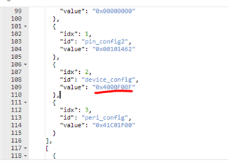

  • Hi Eric-san
    We received register information from the customer.
    This is register information for all addresses showing a status of SYSTEM_IDLE.
    Higa

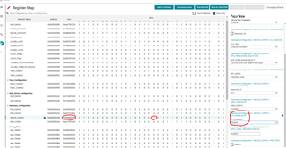

  • Hi Higa-san,
    The register map provided above still has the STL_ENABLE bit enabled.
    When I wrote the customer's register settings into my MCT8316EVM, I see that the device STATE gets stuck in MOTOR_BRAKE due to the previous issue, but I don't observe the SYSTEM_IDLE state. Once I've cleared the STL_ENABLE bit using the steps I provide above, the device returns to MOTOR_IDLE state.
    Could you please make sure that they've disabled the STL_ENABLE bit based on the previous instruction that I provided?
    I've also checked with our firmware engineer who developed the MCT8316A's algorithm, and he couldn't think of a scenario that could cause the device to get stuck in SYSTEM_IDLE.
    If you are able to confirm that the STL_ENABLE bit is NOT set, and the STATE is still stuck in SYSTEM_IDLE, then can you please do an ABA swap between a good board and a bad board and see if the issue follows the IC or the PCB?
    Eric C.
