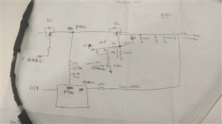

The customer want to know whether VM and Vdrain can use different power supply rail.
Hey Fabio,
Please take a look at slides 5 and 6 here:
And this post: https://e2e.ti.com/support/motor-drivers-group/motor-drivers/f/motor-drivers-forum/1296576/drv8718-q1-vdrain-external-connection
Jacob
Customer did not show external HS/LS FET for motor driving. Please refer bellow. As long as customer connect this way, no problem.
