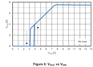

  • Hi Niklas,
    Thank you for your reply.
    VIN and UVLO signal are above enable threshold, FB is not always below target reference voltage (it has some spikes throght 1.2Vref (internal voltage reference, i don't know if you mean this), VCC is always zero, SS is ramping up but decade after 0.05s more or less. How i can resolve this issue? Maybe my .lib is not the same in the webench simulation, if this is the case can i have the test bench related to your .lib on TI? Thank you.
  • I'm sorry VCC is always positive and stay at 7V. Can you help me modify .lib in order to obtain the same as the webench standard simulation? Because i'm not sure it match the test bench of webench. For example where i can choose my pwm frequency in the .lib file?
  • Hi Alessandro,
    Thanks for giving the values.
    Before looking into the lib file, I would suggest investigating the model behavior first.
    So VIN, UVLO and VCC have the correct values.
    If SS starts to ramp up but then goes back down, the device is actually trying start up, but then resets.
    Based on your signal description, this would mean that the device starts switching for a short time but then goes back into shutdown.
    If this is the case, it might not be a problem with the netlist, but with the testbench schematic instead.
    One reason for shutdown could be the overcurrent protection which is triggered due to large inrush currents at startup.
    Could you run a simulation with very light or zero load and see if the output voltage comes up to the target?
    How do the driver signals LO & HO look like? Is there an active signal, or are these staying turned off?
    Thanks and best regards,
    Niklas

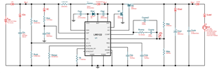

  • Thanks Niklas,
    I resolve this issue but now i have another question: i configure my lm5122 in dual phase configuration, as follow:
    Without load, it seems to work pretty good, while i connect it to a resistive load (8.5 Ohm) , Vin=Vout Disappointed
    How i can solve this other issue?
  • Hi Alessandro,
    Two both phases never start switching at all, or do the devices try to ramp up the output voltage but then start to reset?
    If the simulation works fine without load and only shows errors with load, the device may hit the current limit.
    I would recommend to check all simulation signals mentioned in my very first comment and also check if the CSP-CSN voltage goes above the OCP threshold.
    Niklas

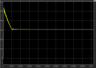

  • This is my Vout
    1) Vin and UVLO signals are above vthreshold
    2) Both FB below target reference (Fb of master is more or less 0.6V, fb of slave is on vcc and is at vin)
    3)VCC ramping up both
    4) Vss ramping up both
    I have a doubt on the topology: mode pin of master should to be on mass and mode pin of slave should be on vcc, right?
  • Hi Alessandro,
    Thanks for the waveform.
    It looks like the supply is turned on and creates an overshoot, but then Vout goes down to Vin and device never starts switching.
    If all startup signals are active and Vss fully ramps up without reset, the devices should indeed start switching.

  • Hi Alessandro,
    With this new information, I am starting to loose the overview of this case.
    Before you were simulating in Simscape, but now you mentioned that it is the TINA-TI model. Also, that Vss is not stable anymore and decreases/resets.
    Can you clarify once more what simulation setup you are using and what signals you are seeing?
    If VCC is not supplied externally, it should follow the input voltage until 7.6V, when the LDO takes over. VCC should be unrelated to Vout in this regard.
    Is this the voltage you are seeing?
    Niklas
  • Hi Niklas,
    I'm sorry i was not so clear, i simulate in simscape the TINA-TI model of dual phase boost converter with good result! So i validate the import in simscape through the simulation on TINA-TI.
    Now i'm facing another problem with my design, a boost converter for 1.4Kw. The problem is that i have on Vout some spike to my reference (50V) but Vss ramp up and after a while decrease to zero. When it happen, what is the most common problem?
    This is the Vout:

  • Hi Alessandro,
    Thanks for clarifying.
    If Vss is observed to start ramping up and then resets, the most common root cause is a trigger of the OCP.
    In a physical design, the solution to this is increasing the SS cap to slow down the ramp up curve and reduce inrush current.
    The disadvantage on simulation side is, that the strongly increases simulation time.
    Niklas
