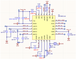

Could you please help review the DRV8889A-Q1 schematic and give some comments? Thanks!
In addition, if the nFAULT pin don't be used, it can be left open?

There are no big issues on the schematic, but here are a few things to consider:
1) Even though nFAULT is not used, it still needs a pullup to DVDD. Right now, the way it is configured is fine; the test point on nFAULT helps for debugging purposes (can trigger on nFAULT falling)

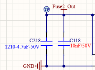

Is the 4.7 uF cap the only bulk capacitance on the board? Do they have any other bulk caps on this board?
Keerthi
Hi Keerthi,
Thanks for your comments!
There is also a 47uF electrolytic capacitance shared by 7pcs DRV8889A Q1, each DRV8889A - Q1 chip has a 4.7uF capacitance next to it.

See the attached draft of our updated app note "Bulk capacitor sizing for DC motor drive applications":
Bulk Capacitor Sizing for DC MD Apps DRAFT.pdf
