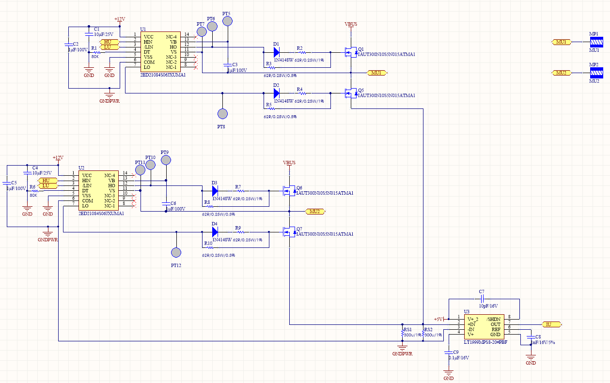

We're using a 6-layer PCB, with just over a dozen of the MOSFETs IAUT300N10S5N015ATMA1 from Infineon technologies. The circuit is controlled by a gate driver 2ED21084S06JXUMA1 and operate with a 12V input voltage. These components will generate heat. In normal operation, the board should be able to deliver 120 A continuously. Currently, it delivers only 90 A.
  • Problems :
We've noticed that when testing our prototypes, some pairs of MOSFETs in series (in a half bridge configuration) are short-circuited between VBUS and GND (see schematic screenshot), as both MOSFET gates are open at the same time. This Miller Effect could cause cross conduction and could be a reason why our board heats up excessively and doesn't reach the desired voltage.

Arm 1 schematic :

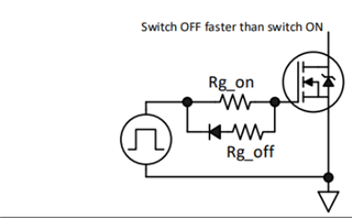

  • Hi Mati,
    I suggest you can rotate the diodeD2 and D4) in driver circuit like below. This can reduce the driver resistor on the falling edge of the low side, thus making miller plateau shorter.
    Colin

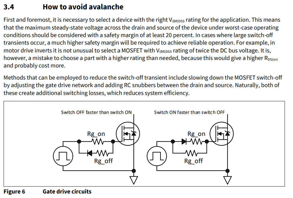

  • Hi Colin !
    In theory, if I refer to what is written in the Infineon datasheet "Designing with power MOSFETs". In this configuration, the diode slows down the rise time (switch-on) of the gate voltage, while at the same time allowing a fast gate discharge on switch-off. This should already reduce the chances of cross-conduction with a fast switch-off, given that the switch-on is slowed down by default. I suppose, but I'm not sure, the Miller Effect should be caused by faster transitions?
    From what I understand, in such cases, we leave the diode orientation with the cathode towards the gate input and add RC snubbers or RLC.
  • HI Matis,
    Because  miller effect can be seen on the falling edge of the low side in your waveforms, it is necessary to faster switch off speed like below shown. This can shorten miller plateau.
    Colin
  • Hi Colin,
    I didn't make the connection the first time.
    I understand now, it's very clear. I'll make the modification and test my prototype to see how it goes.
    Thank you very much Slight smile !
