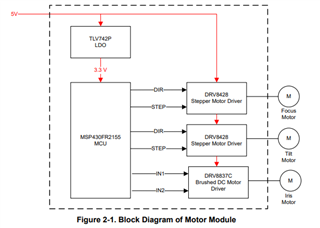

My customer is looking for lens controller for the IP cameras. May I know if there have the P-IRIS motor driver controller?
If there have any solutions, please advise it. Thanks!
Hi Henry,
The DRV201A would be a good solution for lens control of IP camera. We typically see both brushed and stepper motor drivers often used as well for IP camera design.
Motor Module Design for IP Network Camera Based on MSP430FR2155 (ti.com)
Some of our newer stepper drivers such as DRV8845/49 are commonly used in IP camera applications.
DRV8845 data sheet, product information and support | TI.com
DRV8849 data sheet, product information and support | TI.com
