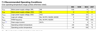

  • Hey Dhruvit,
    Apologies for the confusion.  VM is Motor Voltage input for the device.  So in your case you would connect your 12V to the device.
    See the datasheet:
    You can also check out the EVM to see an example schematic and PCB layout (download the Hardware Files):  https://www.ti.com/tool/DRV8212EVM
    However, DRV8212 should only be given a maximum of 11V on VM, and typically you should design for a 20% margin on VM for safety.  So I don't recommend using more than 11*0.8 = 8.8V on VM of this device.
    For a 12V system check out DRV8220 as it is rated for 20V.

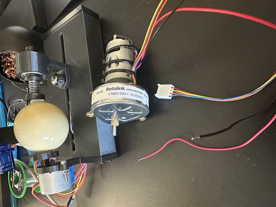

    My Setup:
    • 12V Brushed DC Motor (VCC, GND, Forward, Reverse terminals)
    • 16V-20V Battery (fluctuating voltage)
    • TPS62933 Buck Converter (regulated 12V output)
    Question about VM Pin:
    The datasheet mentions a maximum input voltage of 11V for VM. I'm confused about the purpose of the VM pin since it seems to be both an input and output for the motor voltage.
    Here's my specific question:
    Can I simply connect the regulated 12V output from the buck converter directly to the motor's VCC pin and leave the VM pin unconnected? My concern is that bypassing the VM pin might cause issues with the DRV8212 functionality or damage the motor.

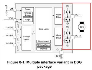

    What you are describing is Independent 1/2 Bridge control mode, which this device does support but it still needs the motor voltage (12V in your system) on the VM pin.
    This is basically what you are describing, but note VM needs to be the same on the driver and on the high-side of the load:
    So 12V in this case will still kill the device.
    • Is the VM pin an input, output, or both for the motor voltage?
    • If it's an input for the DRV8212, how does the DRV8212 utilize the voltage on this pin to control the motor?
    It's an input for the motor voltage.  Then it will go through a FET (think of it as a switch) and be given to OUT1 or OUT2.  See the red section here, think of each FET as a switch:
    Jacob
  • Hi Jacob,
    Thanks again for your help with the DRV8220.
    Basic Connections:
    Based on the datasheet, I believe the basic connections are:
    1. Motor VCC to DRV8220 VCC (12V supply)
    2. Motor GND to DRV8220 GND
    Control Mode Confirmation:
    Could you please confirm if the recommended control mode for forward and reverse operation with a brushed DC motor is PWM (IN1/IN2) or Phase/Enable (PH/EN)?
    Connection Details Request:
    While I've reviewed the datasheet for specific pin connections in the chosen control mode, I'd appreciate it if you could provide a quick reference or confirmation for the following connections to control the motor's direction:
    • Forward direction connection (IN1, IN2, PH, or EN pins)
    • Reverse direction connection (IN1, IN2, PH, or EN pins)

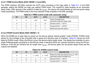

  • Hey Dhruvit,
    You can use either, just follow the datasheet tables for your desired outcome.  PWM will require 2 PWM-capable pins from your MCU for pwm control in both directions.  PH/EN can be thought of as "Direction / Speed" control, so just 1 PWM capable pin is needed to control the speed.
    Follow the H-Bridge control tables in the datasheet
    Check out this video, it might help ya:  https://www.youtube.com/watch?v=up5edFaToq4
    Best of luck, hopefully this helps!
    Jacob

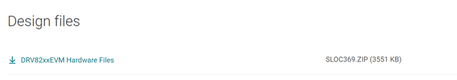

  • Hey Dhruvit,
    Do you have an oscilloscope or logic analyzer you can use to verify your signals are getting proper voltages?  The pin on your MCU for IN1 (for example) should be set in the MCU as and OUTPUT pin (no internal pull-up or pull-down enabled).
    Do you have a https://www.ti.com/tool/DRV8212EVM to test with?
    For the schematic, download the Hardware Files from that EVM page - that will give you the Schematic and PCB layout
    Jacob
  • Hi Jacob,
    Thank you for this most valuable information, about this function I will take care of that and also includes notes in schematic to not trigger internal pull ups and pull-down resistor, although I am also thinking about high impedance gpio level, thanks a lot to clear my doubts.
    Thanks & Regards
