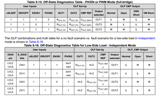

My customer tested the off-state diagnostics and they found the result did not match any status.
nSLEEP = 1  DRVOFF = 1
BLUE: OUT2
GREEN: OUT1
YELLOW: IN1
RED: IN2
Result:
IN1
IN2
OUT1
OUT2
1
1
0V
4.9V
1
0
350mV
0V
0
1
350mV
0V
0
0
0V
350mV
Can you tell me what they should test in next step?

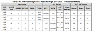

  • Hi Peter,
    Off-state diagnostic should use nFAULT pin or OLP_CMP output to judge the result.
    And MODE is also important. Which mode is used? If Independent mode, DIAG pin or S_DIAG is also important.

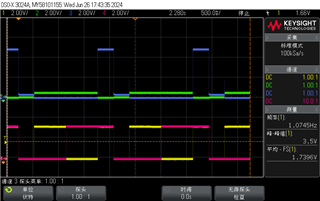

    They have another problem now:
    They set nSLEEP = DRVOFF = 1, IN1 = IN2 = 0. They saw 350mV on OUT1&OUT2 pin. In the table it says OUT1&OUT2 should be Hi-Z mode. Then they connect OUT1&OUT2 to GND with a pull down resistor and found the 350mV still exist.
    You can also see the 350mV waveform in the picture above.
    They want to know why this 350mV exists. They want it to be 0 otherwise it will affect their ADC diagnostic.

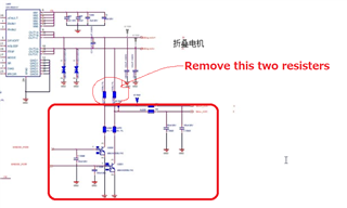

  • Hi Shinya,
    Pls check schematic below.
    Peter

    350mV should come from outside of DRV. I suggest removing two resisters bellow to disconnect from their external circuit. And remove the motor load as well.
    If 350mV is still there after above, please generate new post.
