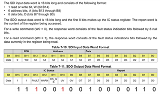

We reworked the board by replacing the motor driver with a new DRV8705S. Now, the board powers up successfully, but we encountered an error during driver initialization. The error message is as follows: 'Config IC_CTRL read write stage: 4400, Read: E486'. Please refer to the attached image for details.
Could you please help us resolve this error? Additionally, what could be causing the error mentioned above?
