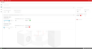

b.Open the DRV8847EVM GUI and select "Parallel mode" and do "Driver Enable", you are going to
see:

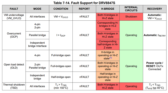

1. "Fault Status" turns to red with no load at output. This is because the open load detection
function
2. "Fault Status" keeps green with a 15ohm load at output.
Measure Mode pin; nSleep pin and IN3 pin are high (3.3V). IN1, IN2 and IN4 pins are low.
 Here same I have done ;selected parallel mode in GUI and enabled driver showed nFault red ;
measured ,nSleep pin and IN3 pin are high(3.2V approx 3.3V ) and IN1,IN2 and IN4 are also low
->but, after adding the load of 15ohms ,nFault is in red only (this is the first observation)
c. Enable "IN1" and set 100%, the IN1 voltage is 3.3V and OUT1-3 output is 8V on EVM, 512mA
current flow into the load.
Here I have enabled IN1 and set to 100% so that
I have observed 3.3V at IN1  BUT OUT1-3 output is 0.003 approx 0V across each output with ground it is varying between 200mv to 300mV)
Even tough I have tried multiple methods
  • By varying the duty cycle of the inputs at a time both IN1,IN2 or IN1 ON and IN2 OFF or IN1 OFF or IN2 ON
  • BY removing Jumpers J6;J7;J8 and J3(with push or reset and without )
  • By varying Ramp Rate and Torque Scalar
  • Even Though I changed the modes
But Output is not reflected
