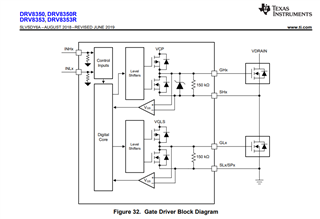

    The datasheet also mentions "In sleep mode and when VVM < VUVLO, all external MOSFETs are disabled. The high-side gate pins, GHx, are pulled to the SHx pin by an internal resistor and the low-side gate pins, GLx, are pulled to the PGND pin by an internal resistor". Can you please share the value of these internal resistors as I don't think this is specified in the datasheet?
    I believe the pulldown resistances are 150kOhm and are shown here in the given system block diagram:
    I hope this information has been helpful, and please reach out further if you have any additional questions!
