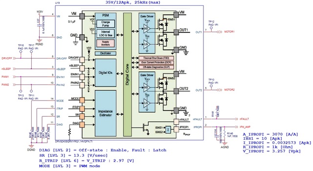

I'm using DRV8243SQRXYRQ1.

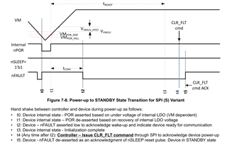

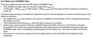

After powering on, the nSLEEP PIN is injected at 7.5usec low pulse, but the nFAULT PIN does not change to High.
May I know why?
1. DRVOFF PIN is Low.
2. nSLEEP PIN is High -> Low(7.5usec) -> High.
3. nFAULT still Low.
