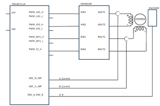

We are considering the possibility of connecting Field Oriented Control and DRV8424.
We plan to use the following products for Field Oriented Control.
https://www.analog.com/media/en/technical-documentation/data-sheets/TMC4671.pdf
As far as I can see from the DataSheet, it seems possible to connect as long as you pay attention to the current limit of the DRV8424P
I would like some advice on concerns when connecting Field Oriented Control and DRV8424. We are considering connecting with the following configuration.
Conor
  • Hi Conor,
    We're not familiar with the 3rd party device. But looking at your block diagram with external current sensing the DRV8424P maybe a feasible solution. The DRV8424P has integrated current regulation using VREFA and VREFB inputs. It should be set to its maximum 3.3 V and current must not exceed 2.5 A else internal regulation will kick-in and affect operation.
