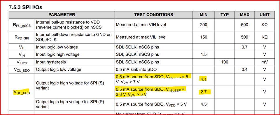

    Short answer:
    1. P-variant requires VDD 4.5 to 5.5 V, Logic interface is 5V.
    2. S-variant has internal digital supply derived from VM. The nSLEEP pin also provides the logic high level for the SDO output - see below capture from pin description in the datasheet. When nSLEEP = 3.3V the device will be awake and the SDO logic high will be 3.3V.
    Regards, Murugavel
