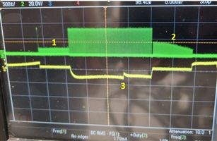

3) I took some image from one of the motors and have some questions-
1- the Beck EMF (marked as 1) in front of the phase doesn't look like the section after the Phase ON section (marked as 2) - any idea ?
2- I would assume the commutation switching (marked as 3)  would accrue in the middle of the ON phase, but it's seems to be out of center by ~20Deg ?
    1. Can you provide a capture of all the phase voltages? Likely the phase voltage during the Hi-Z stage (1) is not being pulled high strongly, this shouldn't lead to any issues but seeing all the phase voltages will help to determine if there is an issue occurring.
    2. For the MCT8316Z the commutation switching point is dependent on the hall inputs. Ideally we do expect the commutation switching point to occur in the middle but due to load conditions or other factors this could be delayed or advanced. Please provide a capture of all the hall signals (assuming you are using digital all) plus the phase current.
