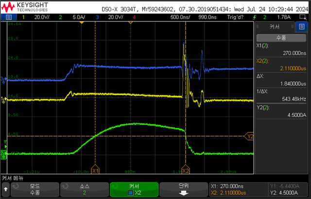

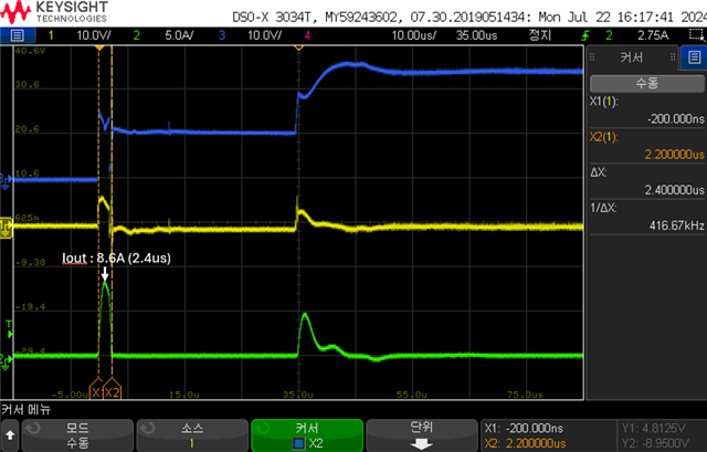

Upon checking with an oscilloscope, an inrush current of 8.6A was observed.

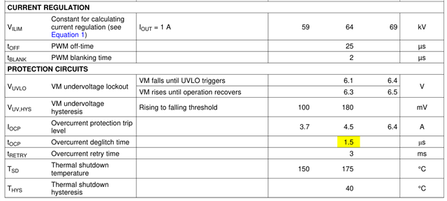

In the following situation, the OCP (Over Current Protection) feature should be activated, but it continues to operate without activation.
Could you please help us understand the reason?
