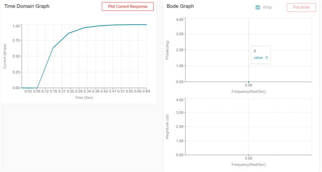

I couldn't click the plot bode. Is there any procedure to check the bode plot?
I can click when I enter demo mode

Bode plot will be activated in the next revision of Motor studio.
Time domain plot if good enough to verify the response behavior to transient input.
Some cases Bode plot can provide idea about system Pole Zero and user can apply shaping
For current Loop device does internally and user need to do any tuning and for the speed loop user can utilize time domain plot to tune.
