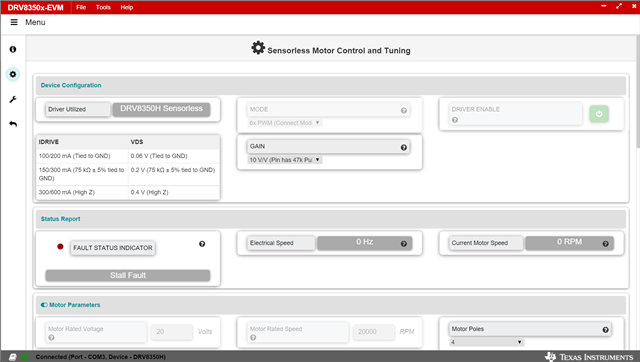

I am encountering issue while tuning the input motor parameters.
I have given motor voltage as 24V and speed as 23000RPM. In open loop acceleration control, for Acceleration Rate I gave as 50Hz, for Acceleration Stop Range = 10,000 MHz and Acceleration Velocity Interval = 10,000 MHz. If I try to enable the motor I am getting error in tuning the open loop parameters. Could you pls provide me clarification to encounter this issue?

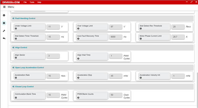

    We are running the motor in Sensorless mode and we are encountering a stall fault when trying to spin the motor. We have also experimented with lowering the motor phase current limit, but the motor runs for short period before showing a stall fault, then starts running again and throws fault repeatedly.
    I have attached a screenshot of the current parameter settings.
    Could you please help us resolve this issue?
    Ramya R

    If the stall condition is occurring during open loop acceleration I would try decreasing the acceleration rate and increase the stall detection timer threshold. If the commutation pattern is being applied too quickly in open loop, the rotor can lose position and stall.
    Additionally, you may try increasing the back-EMF threshold at which it switches from open loop to closed loop.

    Do you have any comment on the initial feedback Anthony has provided? Can you observe the behavior when increasing the stall detection timing parameter while decreasing the acceleration and motor speed?
    Also, how long can you spin the motor before the stall fault appears? And does the initial fault occur around the same point every time? Does lowering the motor speed/ duty cycle affect this fault occurrence?

    I have tried increasing the stall detection timing parameter and decreasing both the acceleration and motor speed, but the stall fault still persists. The motor isn't spinning - it only makes a cracking sound, indicating it's just initializing before the stall fault appears. Additionally, the fault occurs at the same point every time, even with a lower motor speed or duty cycle.
    Could you help me figure out a solution for this issue?
    Ramya R

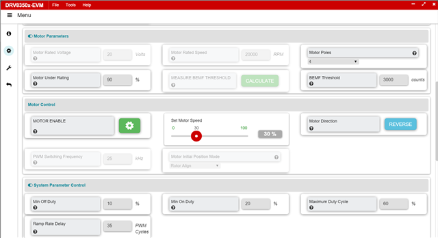

    While I continue to look into this matter, does this fault occurs when there is no load on the motor andthemotor directionis CW (not reverse)?
    Can you also help to double-check the motor parameters, such as the pole pairs given from the motor data sheet?
    Lastly,  can you try setting the voltage derating setting to 50% instead of 90%?

  • Hi Joshua,
    Thank you for your message.
    Regarding the motor behaviour, I noticed that the motor only starts spinning when the speed is set above 30, and not at the initial stage.
    It spins smoothly without throwing a fault at first, but after sometime, the motor stops and then resumes spinning again.
    However, the motor performance is noticeably smoother compared to before.
    I have attached the pdf with current parameter setting for your reference.
    Ramya

  • Hi Ramya,
    Glad to see the performance increase.
    Can you set the stall detection threshold to 5 revs, and also can you measure the motor phase voltages and current when this fault occurs? It may be that an overcurrent event/voltage dip on supply is happening shortly when the motor is trying to spin.

  • Hi Joshua,
    I have set the stall detection threshold to 5 revs but the fault still occurs. I have also measured the motor phase voltage and current values.
    Please find the attached data for your review.
    Ramya
  • Hi Ramya,
    Thank you for the data.
    That current (peak to peak) is very high, reaching nearly 60A (~ ±31A). The DRV8350EVM is only rated for 15A continuous current and 20A peak current, and so this is most likely resulting in the issues observed with overcurrent fault.  What is the rated current for the motor? And do you have a different motor available to test? Reducing this output current to below the rated threshold should help operation.
    -Joshua
