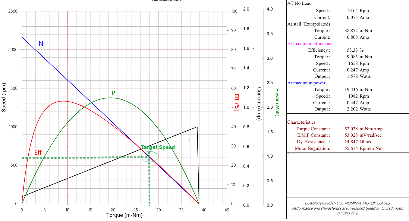

The motor mentioned in the ralated thread arrived, its parameters the motor supplier provides are as following:
Wire Resistance: 11.5Ω
Wire Inductance: 4.7uH
BEMF Constant: 53.028 mV/rad/sec=around 333mV/Hz
Poles: 12
Format: wye-connected
And its performance curve is attached again here:

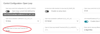

Then set
     -Rated Peak Current: 1A
    -Max Speed: 2000
    -Pole Pairs: 6

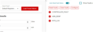

And run MPET, "MPET_IPD_FAULT" was triggered, and the motor could not rotate normal.
[Q-1]What's the reason for this issue?

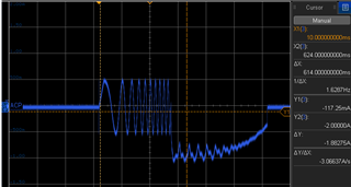

And set the I2C Speed Command Percentage to 50% directy, the motor could start up, but after a while it stopped with "ABN_BEMF"&"MTR_LCK" triggered. Then these fault were cleared automatically and the motor started up again. This process would repeated serveral times, and the motor could not rotate normal, and felt hot when touched after running for around 3 minutes.

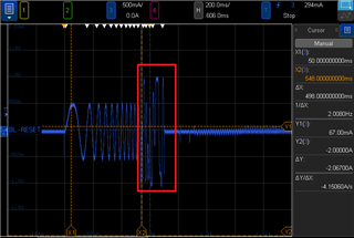

(3)I tried to change the BEMF Constant to a lower value such as 30. The start-up was slow(around 3 seconds) and the motor shaked slightly, then roated normal at the target speed.
[Q-3]What's the reason for the different performance between 333(which is the value the motor supplier gave) and 30?

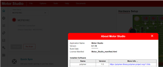

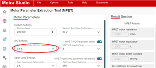

    Please install MOTOR STUDIO 0.1.18 which is published online, available for download. In this we have removed default value and instead allow use a template file.
    I modified you file and adding here below.
    You need to measure R, L as explained in the data sheet, please note the parameter values are per phase quantity.
    Example if you read Phase to Phase resistance please divide it by 2 and program it.
    For KE the motor data sheet says 53mV/ rad/s  , we need mV/Hz, please convert to Hz which is equivalent to 332mV/ Hz
    Answer to other questions
    Q-1, There could be two reasons,
    1. When the motor resistance is very high  and MPET current setting for IPD is set high so that current   not possible to reach to set current threshold for IPD to complete fault happens. To overcome this reduce the MPET IPD current or if you already know the Resistance and Inductance (per phase) program them or using LCR meter measure them and program.

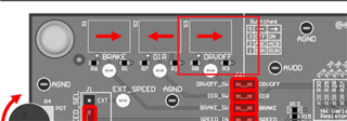

    2. Another reason will be check for DRVOFF switch position on the EVM, if DRV is cutoff due to this there will not be any current output and this error shows up
    Q-2,  Minimum inductance is 6uH, can you re check (measure ). If it is less than then PWM switching frequency will not be able to maintain the continuous winding current,
    For rest of the questions as per motor data sheet BEMF Contant is 333mV/Hz, can you measure manually if possible and confirm?
    What I used is just MoorStudio:
    I changed the MPET IPD current to the minimum value 0.1A, then run MPET in the Quick Spin, the motor just vibrated and could NOT rotate.
    If this value was changed to higher value such as 0.5A or more, "MPET_IPD_FAULT" was triggered.
    I used EVM refering to MCF8316A_EVM_TuningGuide.pdf, and DRV_OFF was set as the following, so it should not be this reason,

    IPD injects current with a magnitude configured, if V/R is not enough current will never reach the threshold.
    Where V is applied voltage (terminal voltage) and the R is Per phase resistance (Phase to CT).
    When IPD current is not able to reach set threshold device sets IPD Fault, hence I took two possible reasons and one you confirmed DRVOFF switch is proper position.
    Regarding Inductance, recommended range is 6uH to 20mH , PWM frequency should be selected min 5 times the R/L time constant .
    Please re check inductance also.

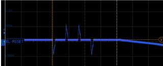

    The motor could start smoothly in most cases. But sometimes the motor would vibrate a little before it switched to Closed Loop. Its current waveform is as following:
    There're some pulses whose peak is out of the OL_LIMIT(here set as 0.5A), and it should be the reason why the motor vibrated before switching to Closed Loop. How to solve this issue?

  • Hi Alex,
    The four pulse which you are seeing are correct. The concept sketch shows for pulse sending in all 6 vectors (0 to 360 degrees), the pulse length with be different at point near to Magnet pole. Current pulses are sent on three phases, if we probe on example phase B, 1st pulse BtoC, 2nd Pulse C2B, 3rd pulse AtoB, 4th pulse BtoA.Other two pulses will be A2C and C2A which is not visible in B and hence you see only 4.
    MCF8316 uses 6 sector to search for the rotor position and this provides reliable rotor position, after successful position identification device starts generating vector at an advanced angle programmed. The advanced angle options help to smoothen the startup current which reduces acoustics, if application don't care for startup time acoustics, then device can start open loop with 90 degrees from the identified position, this starts with high torque.

    Another question is: we used IPD as the startup option, the corresponding current waveform was:
    But it seemed that the 4 pulses(not 6 as the datasheet Figure 7-25 shows) were the same in the above waveform. Could we still use IPD as the startup option?
    By the way, could you kindly help to analyze the issue mentioned in the above? Look forward to your soonest reply. Thanks a lot.
    Alex
  • Hi Venkatadri,
    In addition, I tried several times, and found that the previous few pulses(around 10, exclude the 4 pulses in IPD) were stable. This issue seemed to occur between open loop and closed loop(maybe handoff?).
    The following is anoter waveform of this issue:
    Alex
  • Hi Alex,
    Open Loop acceleration looks high, I am not sure if your motor inertia can support.
    Even if, start with low acceleration  value, say A1 = 10Hz/s and A2=0 , this rate generally works for many motors.
    When we need to accelerate the motor faster OL_ILIMIT also matters, increasing the initial torque cam spin the motor faster , but before set any current limit make sure to set limit not exceeding the rated value.
    Looking at the waveform motor looks like not spinning to the hand off speed.
    You can also enable AUTO HANDOFF and Keep A1, A2 as mentioned.
    Thanks and Best Regards
    Venkatadri S
  • Hi Venkatadri,
    We have to push the display screen in limited time such as 3 seconds, the current A1=75Hz/s&A2=2.5 took around 550ms to enter closed loop stage. If we decrease the A1/A2, the time would be too long, for example, A1=10Hz/s&A2=0 you mentioned would take around 5~6 seconds.
    The open loop should be done, because I checked the frequency of the last 2 ones in the 10 pulses, it was near the value indicated in "Calculated Open to Close Loop Threshold(Hz)".

    I made some changes to the JSON file.
    1. Disabled the speed loop (we will tune the speed loop later)
    2. Disabled ISD brake, just keep resync (This is not affecting, I just made the change)
    3. Enabled Auto hand off, increased open loop current to 1A.
    And, about verifying the motor ability to spin at open loop acceleration there is a method.
    In the Algorithm Control ALGO_DEBUG1->CLOSED_LOOP_DIS, this is volatile value, and this resets back up on power cycle.
    Use this bit to disable close loop, then when we provide speed command motor runs to till open loop to close loop hand off speed and continues to spin at the speed without entering to closed loop forever. We can verify if motor is running in this condition.
    Also, higher acceleration needs higher torque/ current, you can use DACOUT pin, map the speed out value and verify the slope on the oscilloscope.
    Please copy this value
