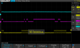

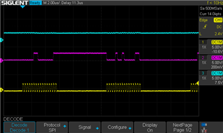

We get no answer on the SDO line of the Motor controller. We measure a SPI signal on the according pins with the oscilloscope which should be right if we compare it to the datasheet.
However, the configuration of the controller doesn't change and it also doesn't provide any answer on the SDO line.
That's what we get on the scope:
And this is what we send to get this data on the line:
MCT8316ZR_WriteRegister(MCT8316ZR_CONTROL_REGISTER_1, 0x03);
MCT8316ZR_WriteRegister(MCT8316ZR_CONTROL_REGISTER_2A, (0x03<<1));
MCT8316ZR_WriteRegister(MCT8316ZR_CONTROL_REGISTER_7, 1);
uint16_t test = MCT8316ZR_ReadRegister(MCT8316ZR_CONTROL_REGISTER_1);
