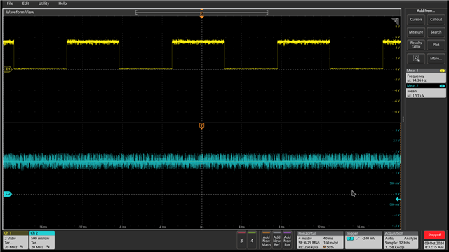

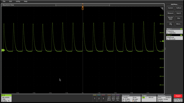

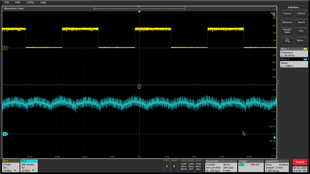

Hi there,
I am designing a board with MCF8329A. When I look with a current probe on the power supply line I see current pulses with frequency around 1.6 kHz (slightly jittering) and amplitude abovef 300 mA without any motor connected/running. This is the same with my custom board and with the standard demo board that I bought initially from TI. I an sending a screen shot from my oscilloscope for reference.
Can you let me know what is creating this behavior and how I can influence the frequency and amplitude of those current pulses, please?
With kind regards,
Alexander.
  • Hi Alexander,
    Can you please read the JSON file and share here?
    Also, test by turning off DRVOFF and BRAKE Pin in ON state.
    Thanks and Best Regards
    Venkatadri S

  • Hi Venkatadri,
    Sorry for the confusion. I have replied to the mail directly, I didn’t pay attention that you are not writing from your mail so my reply will not reach you.
    Thanks for the involvement. Please find the JSON file attached.
    I have tried turning off DRVOFF and BRAKE Pin in ON state – the power current pulses are not affected at all enabling/disabling the power stage and the brake, the picture on the oscilloscope I have sent you initially does not change.
    I was assuming that those power fluctuations are the charging of the bootstrap capacitors of the upper stages but if that was the case the frequency should be changing when the speed of the motor changes. In reality excluding a small jitter the frequency of the current pics is absolutely independent of the power stage. What is existing in the chip with a switching frequency in the range of 1.6 kHz? How the 3.3 V regulator works on AVDD? Is it linear regulator or a witching one?
    With kind regards,
    Alexander.

  • Hi Alexander,
    Thanks for sharing the JSON.
    BRAKE Pin is disabled in the JSON and hence device may try to spin the motor.
    PWM Frequency is 50KHz which will execute FOC at 12.5KHz.
    The speed control is also through Register override mode and hence device will not start with speed pin level.
    I will verify with EVM once and confirm.
    Meanwhile can you remove shunt link jumpers from GUI side of the EVM and verify again, my idea is to isolate MCF8329 and this test is valid only if your custom board also uses same hardware.
    Can you provide more details about your setup?
    Venkatadri S

  • Hi Alexander,
    In general, lower PWM frequency will provide higher duty cycle as compared to higher frequency.
    This is because dead time and blanking time effects.
    What can be happening is if motor R/L is very low then at 25KHz there can be larger current ripple and average current into the winding will be lesser as compared to 50KHz.
    You can re test by monitoring a variable VM Magnitude, when it becomes 100% that means a saturation condition.
    I will re check the JSON provided by you and get back to you.
    Venkatadri S

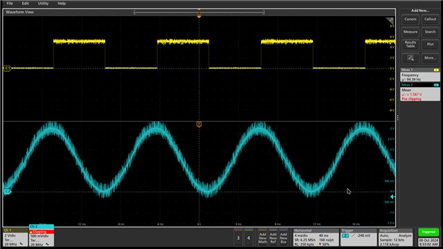

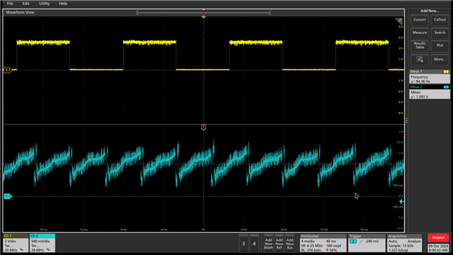

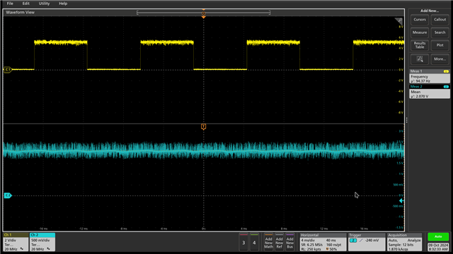

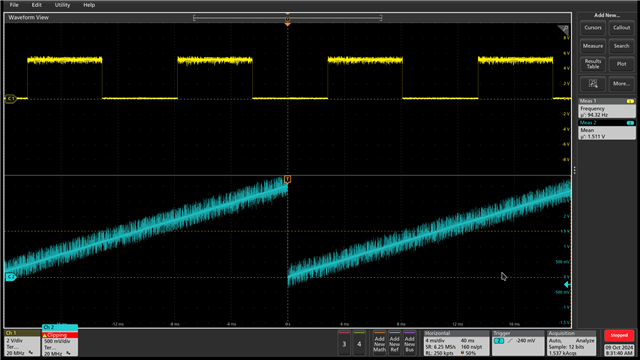

    I have some problems with Id fluctuating while the motor is running. I am sending you some pictures from the oscilloscope for reference. Channel 1 is one of the hall sensors of the motor (just to sync and indicate the physical rotor position) while Channel 2 is the DAC_1 output (I am changing the variable address to show different parameters as listed below).
    THETA_EST
    SIN_COMMUTATION_ANGLE
    ID_REF_CLOSED_LOOP
    IQ_REF_CLOSED_LOOP
    ID
    IQ
    Everything looks like expected for me excluding ID (IQ is also not perfect but acceptable for me, I also the problem in ID is also affecting IQ).
    Do you have any idea what is causing the issue with ID fluctuating while ID_REF should be 0 and the scope shows it stays at 0?
    If you need any additional data please let me know. The motor used in this test is with quite low L and R – 0x0F and 0x10 respectively (it is like that by datasheet and
    With kind regards,
    Alexander

  • Hi Alexander,
    Reason I asked if Flux weakening or MTPA is enabled is ID current also generated along with IQ.
    I made some changes to the JSON
    1. DIG Dead time was too low 200ns, I changed it for 500ns
    2. GD_CONFIG1  CSA_GAIN as 40V/V from 20V/V, this is to adjust BASE CURRENT to proper scaling of 7.5A.
    3. PWM switching frequency to 15KHz from 50KHz, for the 1 shunt higher switching frequency may will have reduced duty cycle due to blanking time. You can try increasing till 25KHz to 30KHz and see if any improvement.
    I am copying the JSON Below, the Last thing to try after testing this JSON is to switch to current more from Speed mode.
