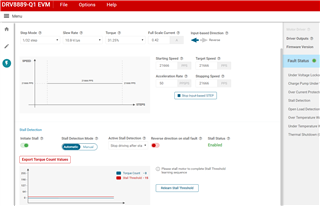

We are using DRV8889-Q1 to drive the stepping motor, and want to use the stall detection funciton. The motor parameters are as following:
Number of Phase: 2
Step Angle: 0.9 degree
Rated Voltage: 4.8V
Rated Current: 0.3A
Phase resistance: 16ohm
Phase inductance: 8.5mH
Target speed: less than120RPM
The setting of DRV8889-Q1 UI is as following(Decay mode is set to smart tune Ripple Control decay mode):
The Torque count was always 0, and the stall fault could not be triggered. What's the reason?
BTW, we want to know if this issue is related to the motor itself? If so, what do you recommend for the motor parameters?

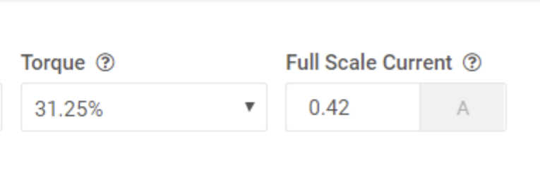

    Thank you for posting in this forum. You mentioned the motor rated current is 0.3 A but the GUI setting is much lower, 0.131 A, what is the reason? 0.42 x 31.25% = 0.131. Did you try setting for 0.3 A, Torque DAC = 100%? Can we get a capture of the current waveform at the target speed 21666 PPS 1/32 uSteps?
    What was the supply voltage used for the EVM motor supply? Thank you.
  • Hi Murugavel,
    The motor was tested without load, 0.42 x 31.25% was enough to rotate the motor. I also tried to set Torque DAC to 100%, but the motor would vibrate and make noise. BTW, I debugged this issue with different parameters, this issue seemed to be related to the speed, and I was not sure if it was related to resonance.

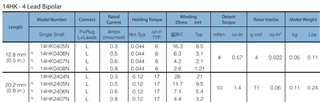

    You could find more information of this motor in the following URL:
    https://www.moonsindustries.com/p/nema-14-smooth-hybrid-stepper-motors/14hk0405n-000004611110014999
    The current motor we chose was 14HK0405N, should we change to 14HK0406N, 14HK0407N, or 14HK0408N for stall detection?

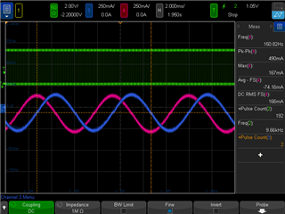

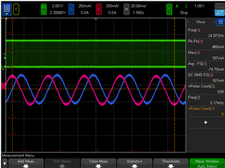

    I measured the phase current‘s waveform last week, sorry for forgetting to capture the waveform of speed 21666 PPS 1/32 uSteps. The other waveforms are as following:
    (1)9666 PPS(close to 21666 PPS under 1/32 uSteps), 1/16 uSteps, 0.42A, 50% Torque DAC
    (2)3200 PPS, 1/32 uSteps, 0.42A, 50% Torque DAC
    12V.
    Alex
  • Hi Alex,
    Thanks for the additional details. While resonance affects full-step and half-step I don't anticipate severe resonance issues at 1/16 or 1/32 steps. The current waveforms you shared looks clean. This seems like a reasonable setting, "9666 PPS(close to 21666 PPS under 1/32 uSteps), 1/16 uSteps, 0.42A, 50% Torque DAC". With these settings what was the torque count, still 0?
    Lower DCR and lower inductance would give better results for stall detection. It will make sense to compare 14HK0407N vs 14HK0405N. I've never had the opportunity to test with 0.9 deg/step motors so far. I'll try to procure one of these although it might take some time for me to get one of these.

    Could you also please capture current waveforms in 1/16 , 1/32 steps while there is severe vibration?
    Sorry, our company's laboratory resources must be reserved one month in advance, so I could not capture the related waveform for now. But last week I also observed the waveforms while there was severe vibration, it seemed that they were normal, the difference was the current magnitude when applying different Torque DAC under the same speed.

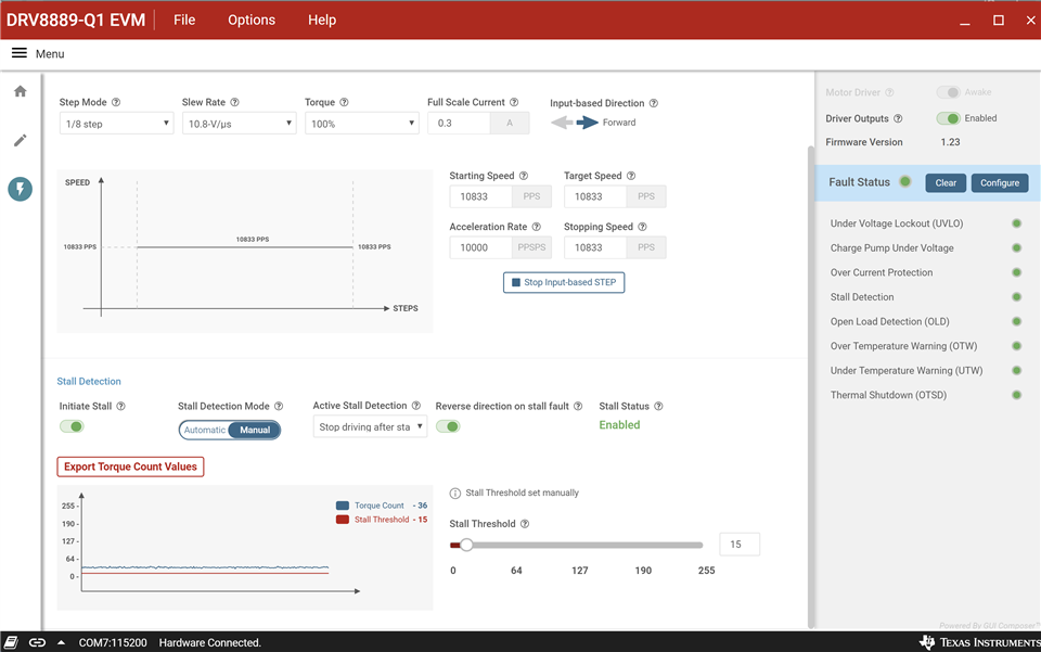

  • Hi Alex,

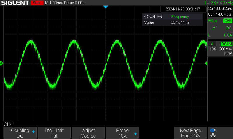

    Sorry this took longer than I thought. I was able to get only a 14HK0406N stepper, 14HK0405 was not available. I ran it with the same RPM as your GUI settings in the first post. One difference is I used 1/16 steps for better torque counts and reduced the PPS by 2 to match. I set the IFS to 0.3 A although the stepper was rated for 0.5 A.
    I was able to consistently detect stall with the threshold setting of 15. The no resistance torque count was 36. See below GUI screen and current waveform.
    Regards, Murugavel
